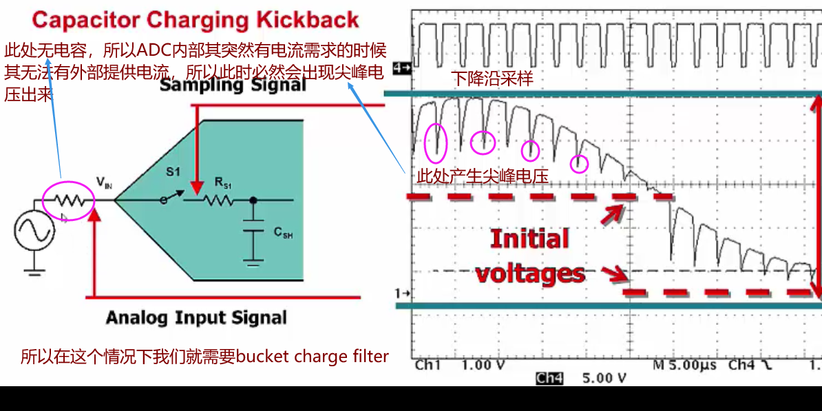

1.混叠问题的产生
falias = ±fnoise  ± K*fsamle
falias = ±fsignal ± K*fsamle
2.尖峰电压的产生:鞭长莫及-->类比旁路电容
3.防混叠滤波器该如何设计
4.charge bucket filter该如何设计
Note: fsignal < nyquist frequency = sample rate / 2
